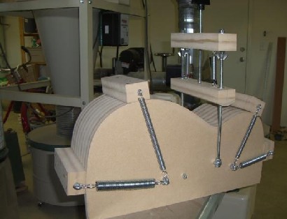

ok, so i finished up my guitar mold and side bender sometime last week and before i went to town bending my actual guitar sides (peruvian walnut), i thought id have a few practice rounds with some quarter sawn red oak (home depot). to my amazement (and delight), i was able to thickness two 36"x4"x1/4" boards to .085" on my thickness planer. i was fully expecting a splintery explosion, but everything worked out just peachy.
heres a pic of my bender. six inches wide. solid MDF. i used one caul at the waist, two at the upper bout, and two at the lower bout.

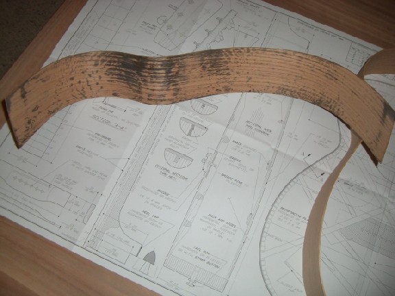

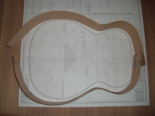

i compensated the form only with the thickness of the wood and one spring steel slat (.015"). my "sandwich" was blanket/slat/wood/slat. fisrt attempt wood was misted with tap water and wrapped in parchment paper. stained the wood and rusted the heck out of my steel slats. second attempt was just wrapped in foil, no water. i studied hesh's side bending tutorial and then went to town. both sides were cooked twice at (?) temperature. im not sure how much i trust the little digital thermomter that came with the side bender. i dont think it ever read 300 degrees, but was on for ten minutes or more. the second side i let sit over night and i think it was worse than the first. so here is my first attempt at bending. im sure youll understand why i think i stink at bending. what in the world went wrong?

Heath...I feel your pain. I am no expert at bending but I did find that I had better luck listening to water sizzling on the bender slats than only following the temp off a thermometer. Some others will need to add their experience but it seems like 10 minutes seems like a little more time than is required. (just a hunch) Unfortunately side bending is as much of an art as a science.
Good luck...Please post your results if you get it worked out.

Hi Heath,
I use Heshs method to bend my sides and have had pretty good success
so far.
It looks to me like you didnt have quite enough heat going to the wood. I
tend to wait untill I hear the water sizzling on the slat rather than rely
totally on the thermometer. On my form I cut the bouts with a slightly
tighter than nominal radius so I can over bend the side slightly and thus
compensate for spring back.
Be careful running your sides through your thickness/planer. With some
woods you can end up with serious tear out and a wrecked side.
Cheers Martin
PostPosted: Thu Oct 18, 2007 1:18 pm
Heath, just looking at the picture, I'd say the second side didn't get hot enough.
Look at the well bent side, see the slight scorch marks here and there? That's an indication of heat.
Now look at the sprung side, see those marks? Not there are they? So, set that one back up in the bender as before, spritz, wrap, and hey, trust that little thermometer, and your nose.
Most walnut bends like butter, so this may be easy if you just don't give up.

Are those marks scorch or blue? Oak is high in tannic acid, and iron oxide from the steel can stain the wood. Though I use tap water I think it can also be a problem if you have water with a high mineral content.

the marks that you see, are blue. not scorch marks. i kinda suspected not enough heat, but i cooked the sides way longer than i had heard of others cooking them. so i wasnt sure... im still not. if the heating blanket (john hall - blues creek) is on for that long, shouldnt it get well over 300 degrees?
the only reason i ran this wood through the planer is because i didnt care all too much if they exploded. i just wanted to see if it would work. i would never run an expensive set of tonewood through the planer. a five dollar piece of oak was worth the experiment.
